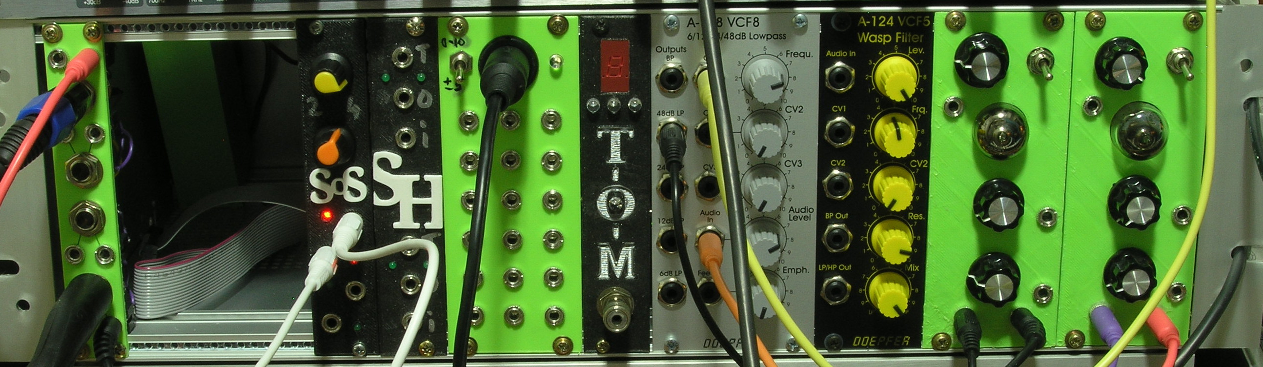

I bought some stuff at Gie-Tec. I remember finding this when reading one of the articles at the Doepfer-site explaining where they get (or got) their panels from. So far I have 3D-printed my front panels, some are in green, some are in black pla. They are sturdy enough, so that works for me.
