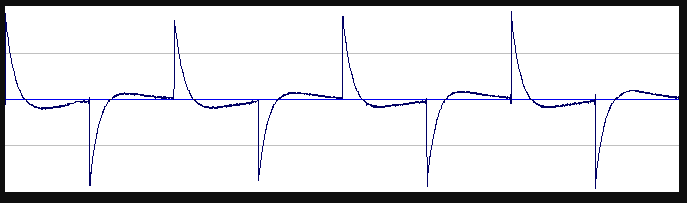

Hell, just look at different models of game boy pulses:
Source: game boy sound comparison
You can listen to examples in the source.
