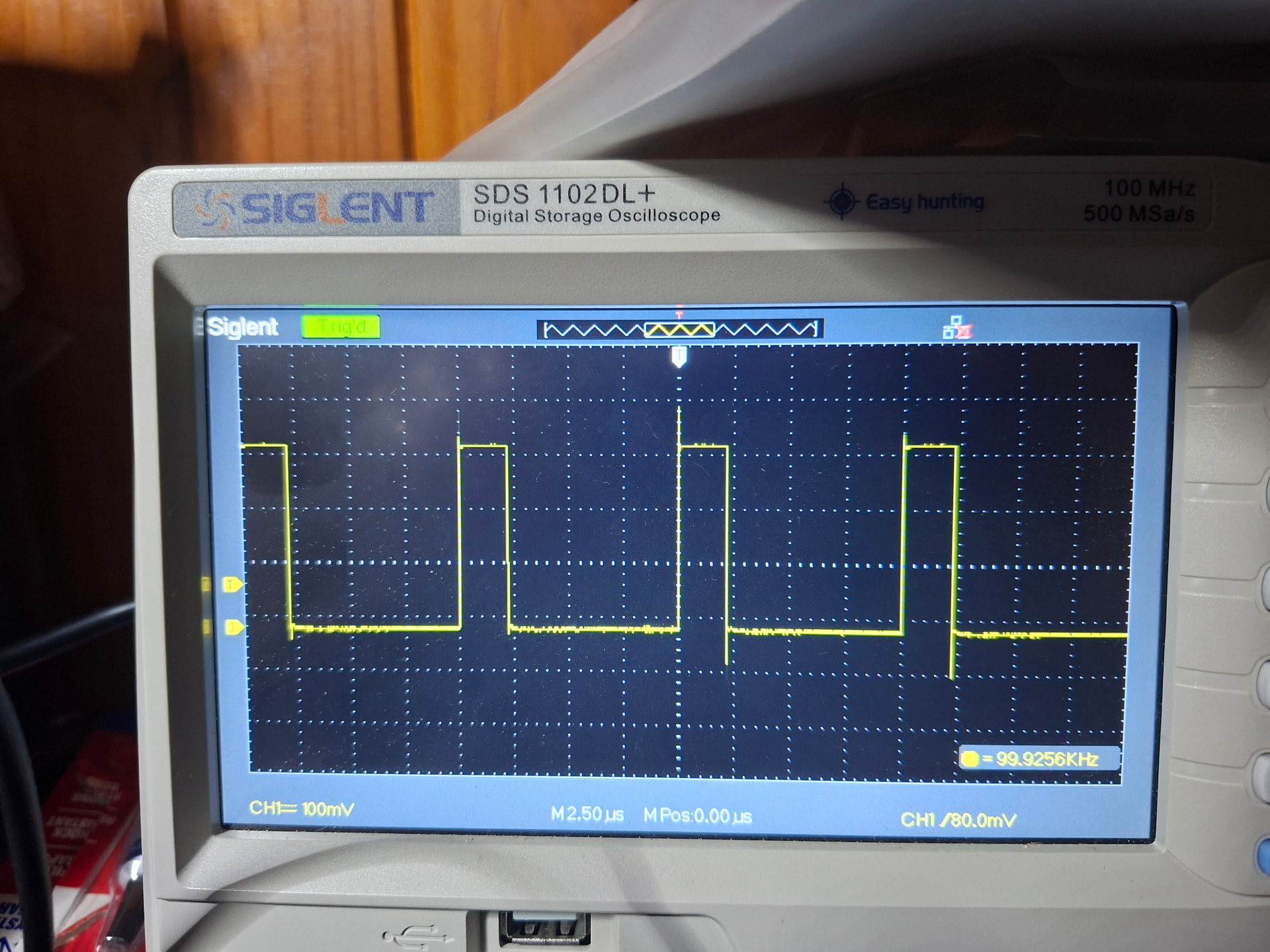

Finally getting back to my build, after life got in the way somewhat. I’m not sure what the output should be from the DCO before it goes into the oscillators - that is the gate/reset/range out of the pico. Are they a voltage, pulse, hi/lo. Just trying to determine if the connection between the midi of the yamaha MX61 keyboard to the octocoupler and pico is working. I have a piar of oscillator voices built but have yet to get the +12/-12V psu built and was just tring to see if the pico part was working.
The DCO is the oscillator, it’s a charge pump circuit.you should have pulse wave and a very narrow pulse for reset I think. Either way when fed into the opamp a Sawtooth is created, the extra parts of the opamp are used to create the pulse wave or PWM when modulated.
Voila
