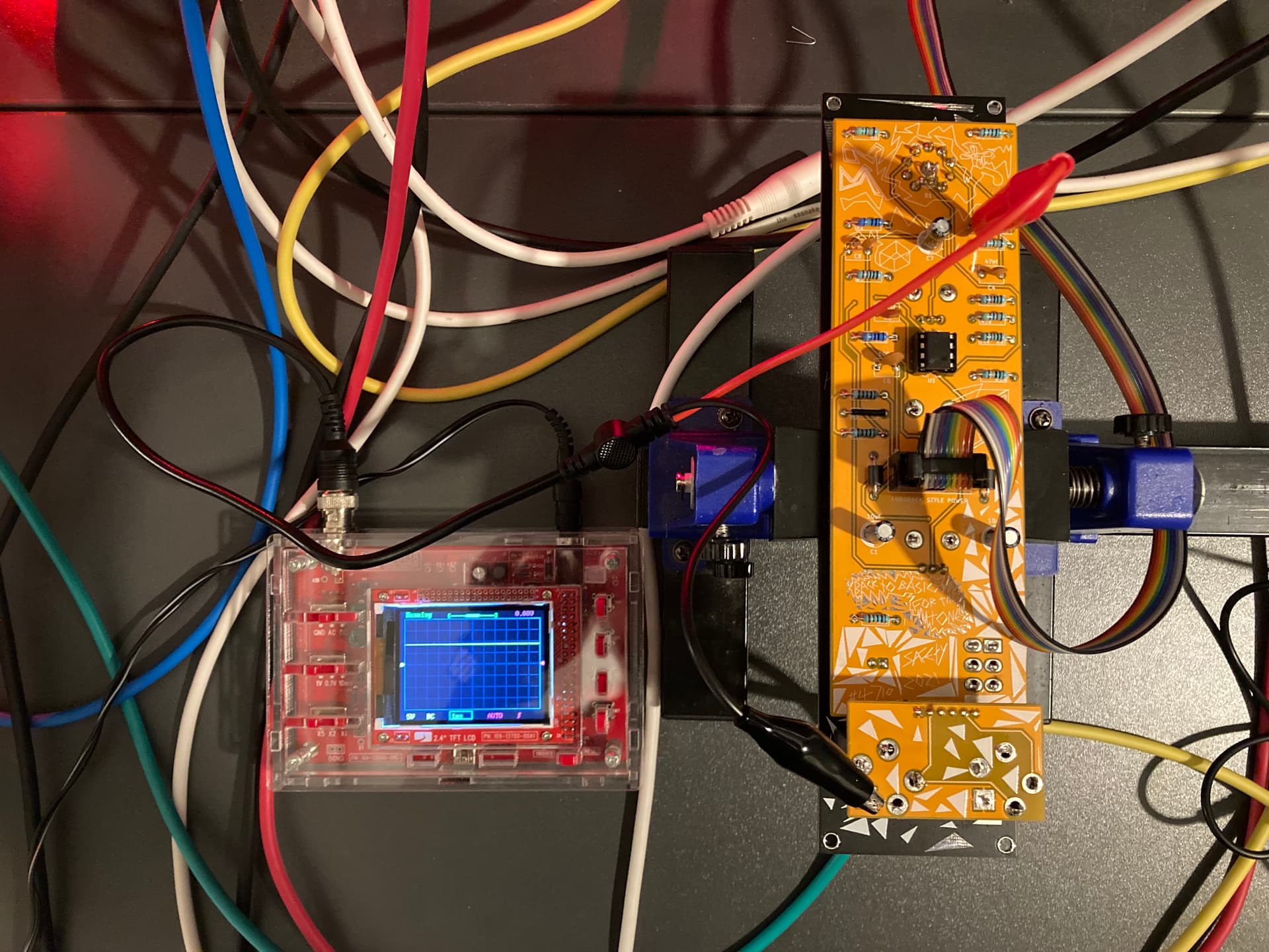

i don’t know much about soldering but can i see the back of your board? I sometimes have a weird thing where if i touch some components like the jack connectors i get funky results, (i know i probably shouldn’t do this but it was one time!) probably some weird grounding issue as you said…i don’t know…you said you re-flowed but i find it weird that it doesn’t work, i can compare it to mine visually as mine works with no faults that i know of but that’s as far as my “expertise” will reach lol

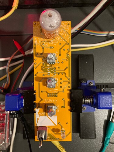

Hey is that tube shiny metal on the inside of the top or is it like a white haze? If so the vacuum is broken and the tube will not work
Hmm it’s like white haze so it’s broken tube. Thank you from bottom of heart that my resoldering mysery is finally over
Yeah blown tube was my first thought, although I would probably expect the heater to burn out ( is there any continuity between 4-5-9 ( may act oddly resistance wise IN Circuit )
Yes that happens also but you can see in the 3rd picture that the tube has lost it’s vacuum. You can tell by the white color. It’s supposed to be shiny metal color.
It can happen when a pin gets knocked, or when you twist the tube when pulling it out of the socket. Age is not very often the cause.
Yeah the tube is toast. Really need to socket this one. I didn’t, accidentally left it on over night and the tube was white the next morning. Could have just pulled and replaced if I would have socketed it but got in a rush. Then trashed the traces getting it out.

Yeah there is continuity. Can I ask what possibly could happened?
